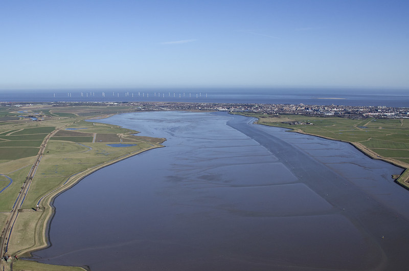

Breydon Water was once a much larger estuary but is now heavily silted. A narrow channel still allows boats and water to flow through, but the rest has become a shallow, silt-filled expanse. In Roman times, with sea levels higher, Breydon Water reached much further inland, forming a huge estuary that could hold massive amounts of water. Might the restoration of this estuary to some semblance of its former state be part of the solution to flooding in the Norfolk Broads?
Breydon Water.jpg (73.72 KiB) Viewed 37492 times
